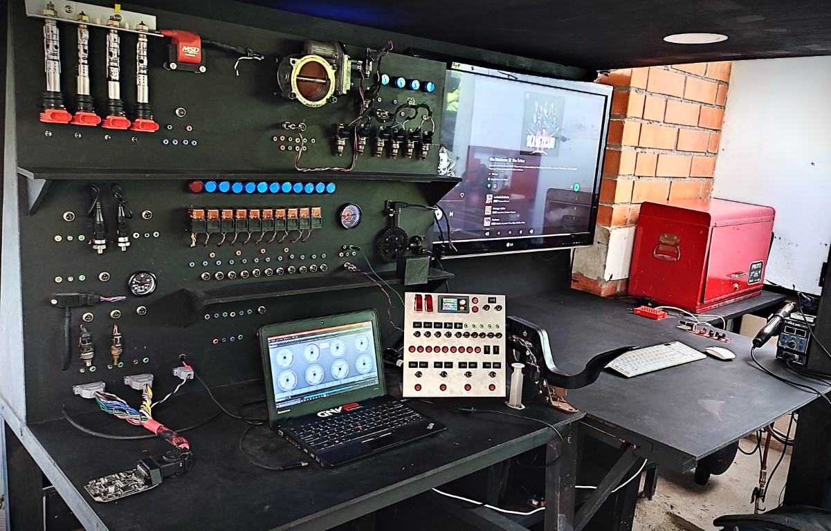

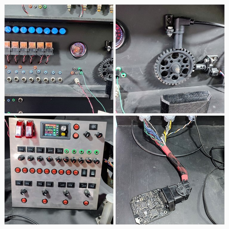

Hello everyone, I want to show you this test bench that we built to test any ecu, it has physical components present in an engine.
It has:
4 Audi / VW coils
8 injectors of > 14 ohms
LS engine ETB
a couple of 0-5v pressure sensors
MAP
2 temperature sensors
Main relay
9 relay outputs
2 12v outputs
Tachometer
36-1 Trigger with VR and Hall sensor
10 analog inputs
Trigger simulator.
If it can be of use to you in any way, it is available for development, testing etc
It has an LED light that turns on with ignition output number 1, therefore we can see the synchronization and charging time of the coil in the trigger.
I want to support the project in some way, I don't have much experience in programming but I think I can support at least in documentation.
