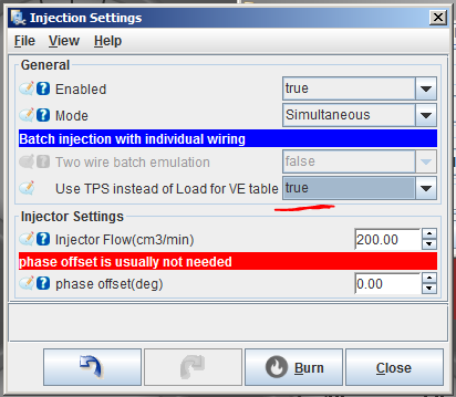

It has problem with fueling...
It seems, the controller not calculate fuel correctly.
(wrong table readings or readings from different table ..??)
I have selected "speed density" algorithm, with TPS based VE map.
In TunerStudio everything look fine, but not in reality.
In rusEFI console look everything different.
I need to answer, why rusefi not calculate injection time from VE table, as I see on Tuner studio ..??
.. in this "combined mode" - Speed Density + TPS based VE table ..
(on many fields are "too high" VE value, it must be injection time around 20ms)
(but I cant see it on any gauge, AFR, logs etc .. )
(engine cut-off due to too lean mixture)

What does "look fine" meanJRD McLAREN wrote: ↑Sat Apr 27, 2019 1:42 pmIn TunerStudio everything look fine, but not in reality.
What "look everything different." mean
I am sorry I am unable to read you mind. Please give exact gauge names, exact actual values and exact expected values. Please give exact tune and logs, with exact screenshots pointing at exact moment of the problem.
Have you considered using more normal modes just to compare?

.see X and Y axes on pictures above.
"Standard" Speed Density mode, with MAP based VE table works fine.
It not works on TPS based VE table.
here is numbers https://rusefi.com/forum/viewtopic.php?f=5&t=1542&p=32934#p32918

picture above shows BARO CORRECTION on rusEfi console
I do not understand how bar correction is related to your VE. "Picture above" is an example of a not specific data point, it's vague - there are too many pictures above

NO ...
it is Volumetric Efficiency

Fields values are the same .. in rusefi console and tunerstudio
but X and Y axes are different ...
then "bad calculate may occur" ...
EDITED:
OK .. just the Y is diff.

Fixed...
I don't now why or how ..
but it's working ...
I try downgrade to snapshot_20190222_0741_stm32f407_rusefi,
edit Y axis on VE Table on rusEFI console, to be the same as in TunerStudio
.. and it started to work ...
Then I try to upgrade (back) to snapshot_20190410_1924_stm32f407_rusefi,
create "brand new project" in TS, on my second laptop
.. and it still working fine . ..
I'm so sorry to waste your time ...
