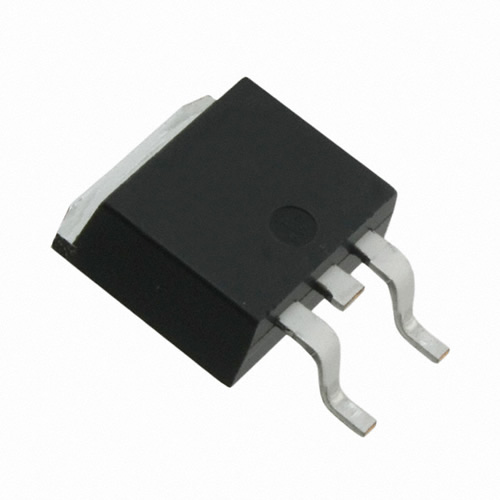

one more thing. iam planning to do a alternative injector driver using this http://www.farnell.com/datasheets/1690219.pdf?_ga=1.164089407.100422501.1434427476
can it drive directly, lets say PE4 on stm disc or need to put some resistor?

It appears that Rg should be at least 4.7k ohm. I would also suggest a pull down resistor, similar to Frankenso R0.4 resistor R404, ect.
Beware the clamp diode between gate and drain. This clamp will dump significant energy into your GPIO pin. I see VGSS is 18V however your GPIO will clamp to about 5V. During these clamping events, you will have current through Rg which will dump to your 5V rail. You need Rg large enough to allow for an 18V gate voltage while not destroying your 5V clamping diodes in side the STM32. As well the mA's that are dumped to the 5V rail need to be consumed or your 5V will raise and damage chips on the 5V supply.
Using this chip will require electrical tuning on your layout to ensure it does not break or fail.

According to the datasheet, Gate threshold voltage = 2..4V, so it's not guaranteed to be logic-level (3.3V max). It may not saturate completely when opened...matt wrote:can it drive directly, lets say PE4 on stm disc or need to put some resistor?

Yes VND14NV04 is the same as what is used on Frankenso. The chip used by @ is simply a thru hole package instead of SO8 SMD package.

Not quite thru-hole but yes, it's just in a different package - "DPAK". You can use exposed copper area with multiple vias on pcb as heat sink for it's thermal pad.kb1gtt wrote:Yes VND14NV04 is the same as what is used on Frankenso. The chip used by @andreika is simply a thru hole package instead of SO8 SMD package.
DPAK:

Yippee! DPAK. That's a good choice, it has a lower Rth than the SO8 package which makes it easier to keep them cold. I figured those vertical thru hole components were the injector chips. I guess those must be the ignition chips. Or who knows, perhaps those chips are simply a slightly older picture. Either way, yes it's a good choice.
