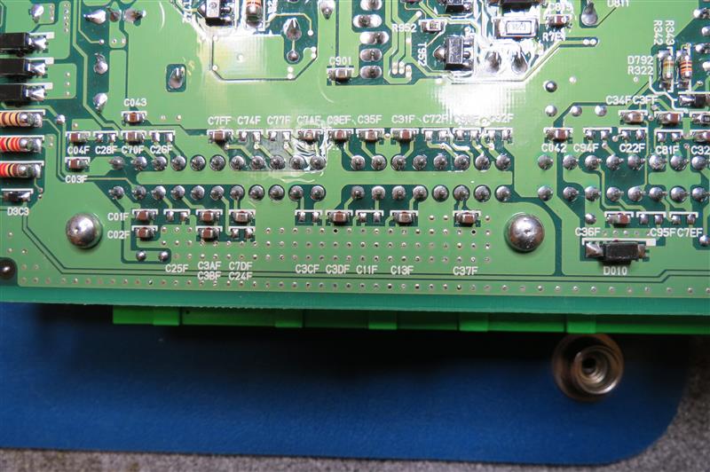

I would recommend that you add an RF ground to the ECU, currently you have a ground that runs all the way round the ECU, that could easily be modified and you would be much less prone to noise issues. Essentially you just need to add a cap to all the inputs and outputs (where practical) which are grounded to a separate ground which is capacitively coupled to the main ground, your RF ground is then connected to chassis by the shortest link possible, on metal cased ECUs its common practice to use the case. the intention is to create a 'barrier' between the inside world and the outside world by creating a low impedance to ground to remove fast transients and high frequencies which helps to prevent unwanted noise coming into or going out of the ECU. Unfortunately most aftermarket ECUs lack this rather basic requirement - MS is rather notorious for noise problems; experience tells me that you could never type approve an ECU without it.
The image below is of a Mazda ECU:
The standard Freescale automotive TPU functions are quite comprehensive and the online configurator produces an S19 file so there shouldn't be any real need to write or compile TPU functions.
The Locost is quite a cool project, one of the guys that I worked with built one with his son who has raced it here in the UK.

Re: Another ECU...
You don't need a TVS, you only need a series resistor followed by a dual diode to clamp the input to the positive rail and then another resistor to limit current into the processors clamping diodes; add caps to filter as appropriate. If you can then size the pull up and the initial series resistor to give protection against short to ground/short to battery.Horizenjob wrote:Another choice I made that I wonder about is I used a Schottky diode and also TVS diode on the analog inputs, but maybe the caps and resistors in the filter would have been enough. Those are BAS70XY and a Bussman SURGX respectively.
Rhinoman
- Posts: 256
- Joined: Thu Sep 24, 2015 2:14 pm
- Location: Wiltshire, UK
Re: Another ECU...
To what level? Current requirements require detection of short to battery and short to ground on all pins except the main power pins. You would also need sanity checking of output durations and current levels as well as a hardware watchdog and hardware limp mode.russian wrote:Well, we do need complex diagnostics and control as well in order to have anything cool. That's where we need software developers and we need process and testing and... Well, it's depressing how much has to be done to have a useful project.Rhinoman wrote:enormous amounts of diagnostics and complex control strategies.
Rhinoman
- Posts: 256
Re: Another ECU...
I should also point out that the RF caps provide ESD protection as well. Typically you would be looking at something like 330pF, 8kV or 15kV discharged through a series resistor (1.5k?). A 33nF cap will give a voltage attenuation of 100 less losses in the resistor, your pull up and series resistor and clamping diodes need to be sized to handle the remaining voltage; in practice I have qualified a number of circuits with a 2n2 or 4n7 cap. The Vitara ECU also uses 2n2 although its quite an old ECU and may have been qualified to a lower voltage level, the minimum is 2kV but OEMs usually specify higher.

Re: Another ECU...
Thanks for the good advice here Rhinoman. It's interesting that grounding is a simple concept and yet one of the most difficult and important ones too. I have watched hardware guys struggle with this for decades and the stuff they worry about on the high speed boards is amazing to me....
I have been conscious of wondering what to do with my grounds. I put in that border ring and it does not connect to the internal ground planes except at the point of ground entry to the board. The board is isolated from the case at the moment, the ground planes do not reach the board edge and I think I have provided enough clearance from the ring around the board to prevent case contact.
I did see in some reference designs that the first layer of caps on the signal inputs where to a chassis as opposed to a board ground. The confusion I have been having is knowing wether I am providing a path to prevent noise from coming in or actually providing a path for noise to come in. The engine's injectors and especially coils have high currents. The drivers for at least the coils need to be grounded to the cylinder head. I don't want the ECU to ever become the ground path for the starter motor. So I was opting to ground ECU boards to the motor. If I include a ground for the caps to the chassis, it seems that would put the noise of the coil and injector currents across the ground to the battery into the signals.
Another things I have done is the CPU has it's own tiny ground and power planes about the size of the CPU package. This ground plane connects to the main ground planes at just one point so I am hoping the ground and power currents from the CPU don't get onto the main ground plane.

About GND planes this is a good article that helps explain and helps people get a gut feel for various GND plane issues. http://www.maximintegrated.com/en/app-notes/index.mvp/id/5450
Some key notes, RF tendencies start at about 1kHz, you need to look at your current loops, solid flood GND planes and flooded planes is generally a good and safe idea. However most of that's more important on a re-spin.
What is your plan for a case and connector? Do you have 3D models of the enclosure? I might be able to convince one of our mech's at work to provide a resonant frequency analysis. We have some nice FEA tools.

Re: Another ECU...
I think I've read the Maxim note, but will go and double check it. Here's a description of what I did with copper zones/planes on this board.
It is a 4 layer board. One internal layer is completely a ground plane. The other internal layer is divided into a couple of areas and also contains 2 short traces. This layer has a ground area under everywhere there is a signal on the bottom of the board. So the bottom signals reference to it. It also contains a zone which carries the aux. 5V power.
The processor received special handling. It has it's own planes for ground, 5V and 1.2V. These planes are the same ( about ) size as the processor package. The reason for the small ground plane here is to keep the local processor currents off the main planes which will help prevent them acting as patch antennas. This should sharply reduce EMI. I did not execute this as well as I would like. Done really properly the processor planes should be well decoupled and then their connection to the main ground plane and the power supplies should also be well decoupled. This provides 2 layers of filtering.
I have also tried to be very careful with return currents by providing balanced sets of ground vias next to every place signals cross from one side of the board to the other.
This board is in reality quite a slow thing with no fast signals, at least I think so. The processor signals are slew rate controlled, the analog is slow and I am guessing the VR chips are also. My concern here then is that a board and the parts of it that are good at generating electrical noise are also susceptible to noise. It is two sides of the same coin.
When I started the design i had some paranoia about the high currents and voltage spikes involved. As it turns out they are all on the top of the driver board so I' not sure it was required. It doesn't really affect the cost of the board, but the cost has been risk and time in my efforts.
