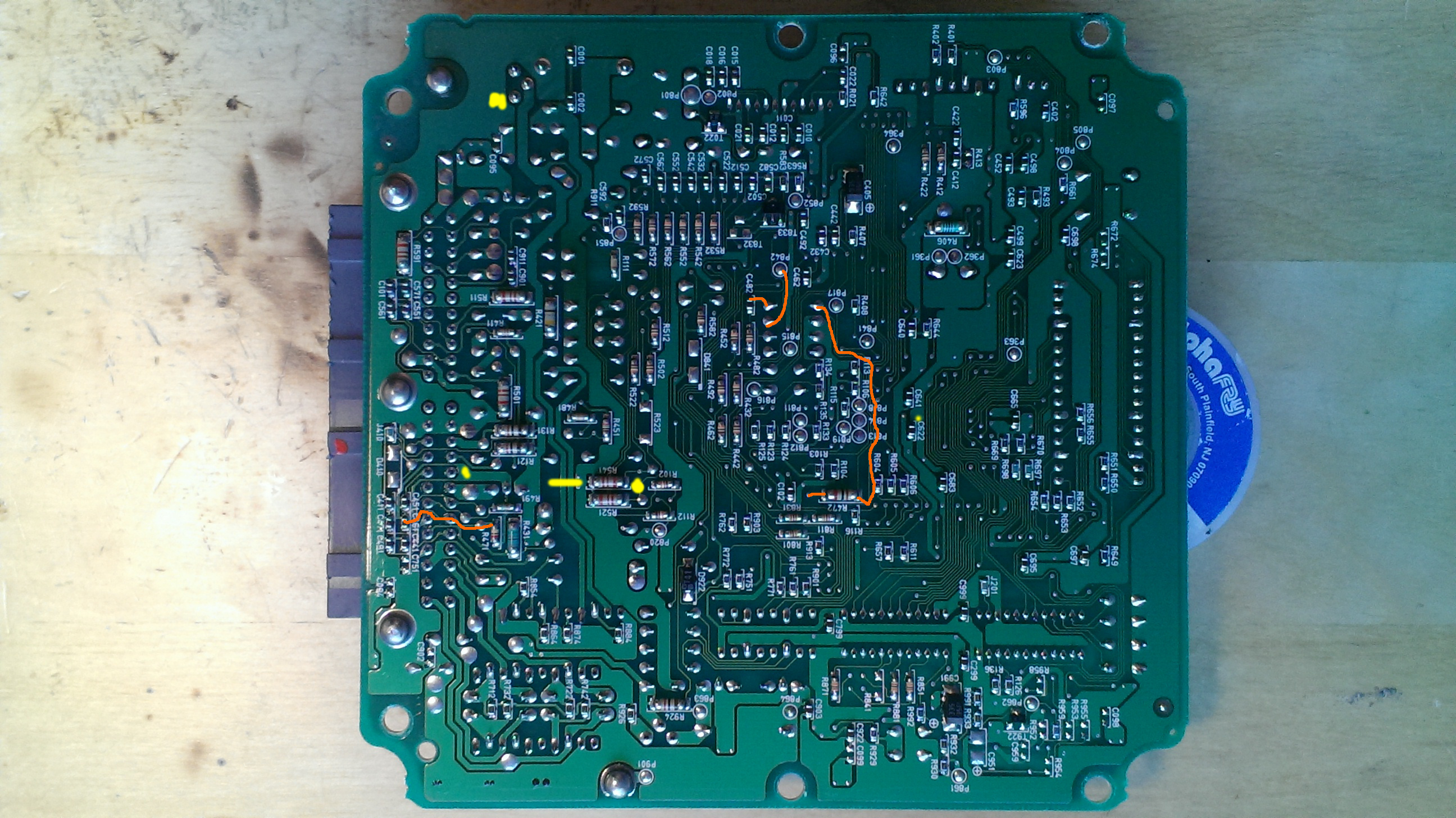

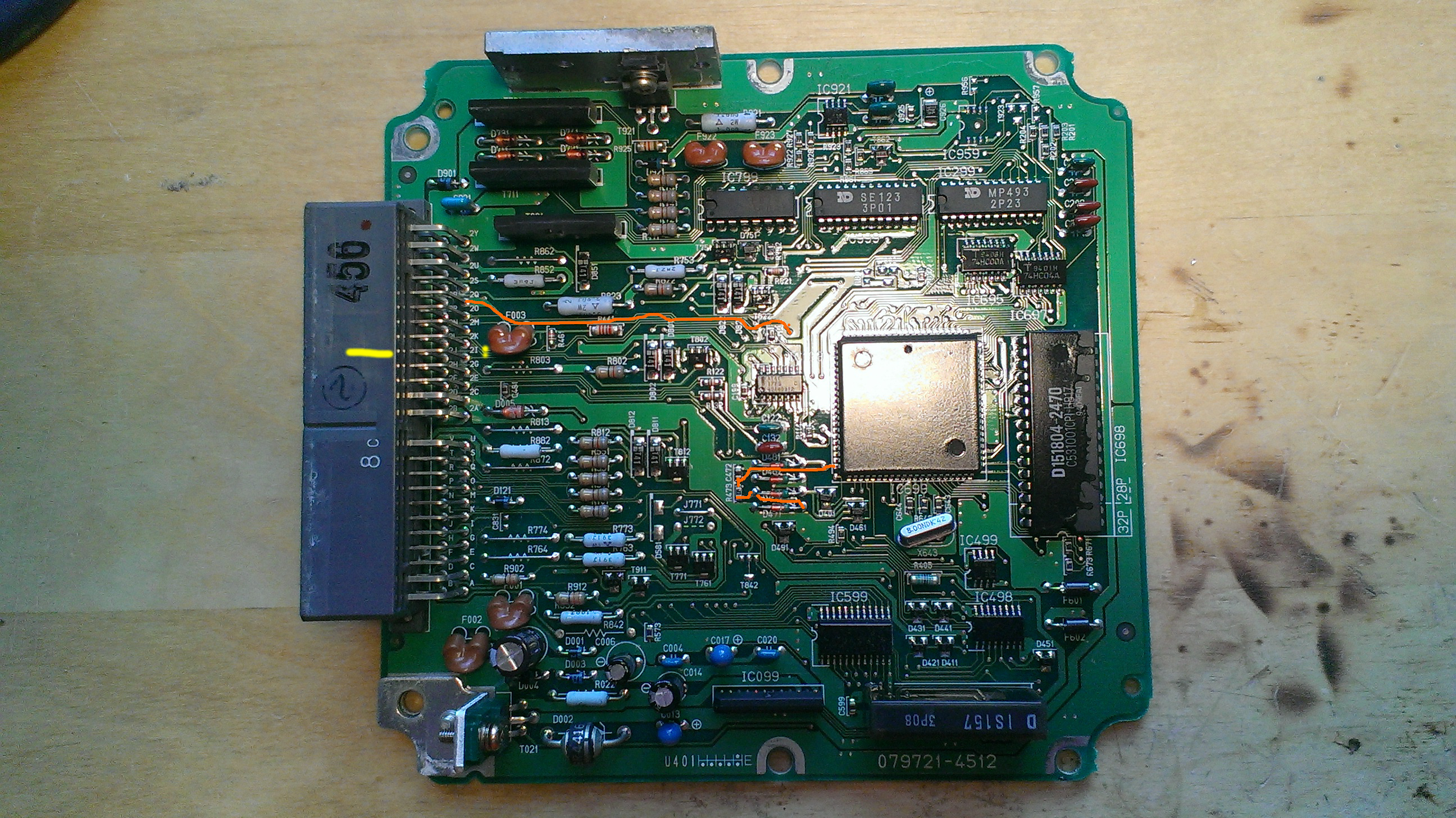

One of the pending issues is how does the MAF sensor provide the signal to the ECU.
On my Ford Aspire with a MAF which is my MAF experience so far, the sensor was providing current (not voltage) and it had to be pulled down with a 1K to be measured, one would measure 1K resistance between ECU pins 2B and 3A - see for pinout.
On the 1994 Mazda ECU I have, I measure 2.25K resistance between 2O and 3A
I've uploaded some pictures of the 1994 Miata ECU here.
MAF input is pin 2O, I can trace it to a via below T822 silkscreen, on the back this goes to a 10K R432 in the middle. Also there is a short trace to a 1.5K R431 which is connected via that wide track to the middle pin of the green regulator?! WAT? Anyway, multimeter shows 2.15K resistance between 2O and logic GND, probably because of D005 which has 615 Ohm resistance.Anyway, the place of EEs is on a bonfire alongside the witches.
2O <- > R471 200K pull-down
2O <-> R472 2K <-> D471 (trace on the back) & D472 (trace on the front) & P842 & R473 18.3K
R473 <->C472 & main chip corner pin
D471 to logic GND
D472 to +5v
See also http://rusefi.com/images/1994_Miata_ecu/IMAG0263_front.jpg http://rusefi.com/images/1994_Miata_ecu/IMAG0266_back.jpg http://rusefi.com/images/1994_Miata_ecu/
See also http://www.ehow.com/how_7816537_test-mass-air-flow-sensor.html
D471 to logic GND
D472 to +5v
