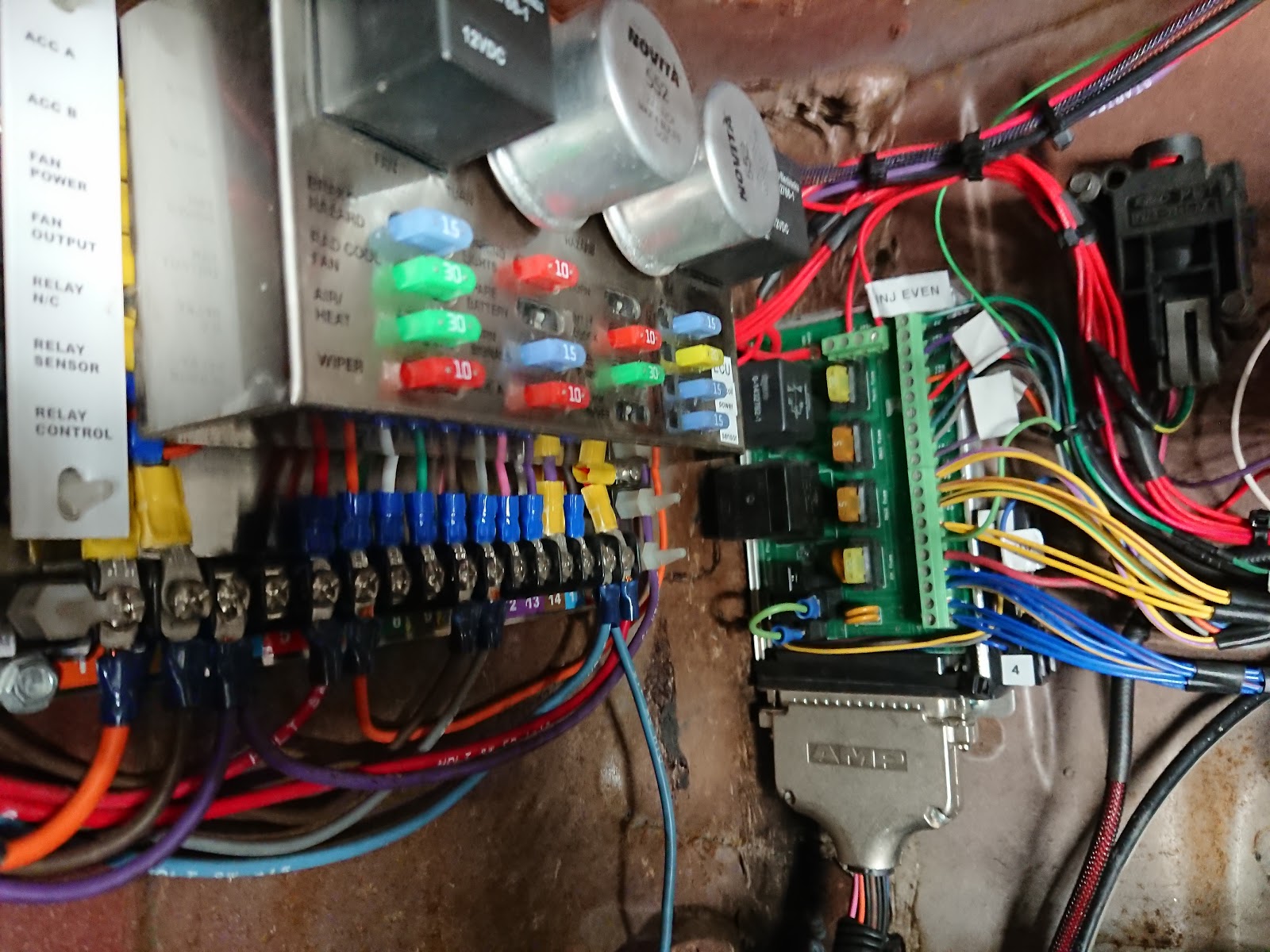

While I was changing over the ECU, I took the time to remake the wire harness (adding several sensors/actuators) and clean up the fuse panel.
Before:
After:
Before:
After:
